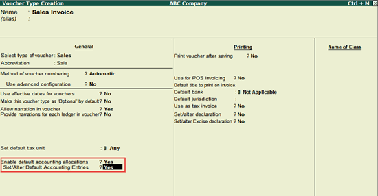

1.    Go to Voucher Type Creation screen. The Voucher Type Creation screen appears as shown below:
2.    Set Enable Default Accounting Entries? to Yes.
3.    Enable the option Set/Alter Default Accounting Entries?.
4.    Press Enter to save. The Default Accounting Entries screen appears.

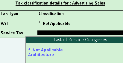

5.    Select the Ledger Name from the List of Ledger Accounts.
6.    Enable the option Set/Alter Tax Class? to view the Tax Class Details screen, as shown below:
7.    Select the Service Tax category from the List of Service Categories.
8.    Define the Percentage.
9.    Define the Rounding Method and Round Limit.
10.  Enable Override using Item Default?, if required.
