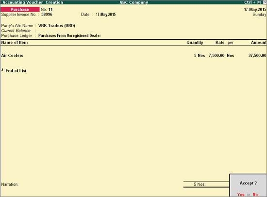

To record a purchase transaction from URDs
2.    Click F12: Configure.
3.    Set the option Allow modification of Tax Details for VAT? to Yes.
4.    Press Ctrl+A to save and return to invoice.
5.    Enter the Supplier Invoice No. and Date, if any.
6.    Select the supplier ledger in the field Party’s A/c Name .
7.    Select a common purchase ledger in which the option Is VAT/CST Applicable? is set to Applicable, and Set/Alter VAT Details? is disabled.
8.    Select Purchase From Unregistered Dealer as nature of transaction in the VAT Classifications Details screen and press Enter.
9.    Select the required stock items whose VAT rates are specified either at the stock group or stock item level. Enter Quantity and Rate for each stock item.
10.  Press Enter to accept the purchase transaction.

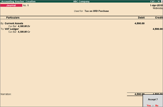

Journal Entry to account for Tax on purchase from URD
To create tax liability on purchase from unregistered dealers
2.    Click J: Stat Adjustment button.
3.    Select the option VAT in the Type of Duty/Tax field.
4.    Select the option Tax on URD Purchase in the Nature of Adjustment field.
5.    Debit the tax on purchase from URD ledger created under the group Current Assets and enter the amount.
6.    Credit the VAT tax ledger created under the group Duties and Taxes.
     Enter the Rate and the Assessable Value for the purchase recorded. The completed Accounting Voucher Creation screen appears as shown below:
8.    Press Enter to accept.
