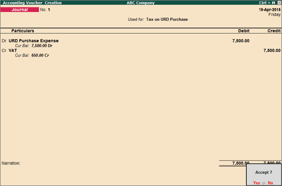

o     Enter the Rate and Assessable Value of the item purchased, in the VAT Details screen. The VAT Details screen appears as shown below:
o     Press Enter to return to voucher screen.
5.    Enter Narration, if required.
The journal voucher appears as shown below:
6.    Press Enter to save.
