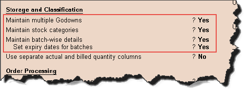

For the advanced mode, including selection of costing methods, you have to enable advanced configuration and features for stock item master in F12: Configure and F11: Features .
The advance configuration parameters for stock item master under F12: Configure (Master Configuration) are shown below:
The advanced features for stock items in F11: Features are shown below:
Note: You can configure the entire setup according to your requirements. According to the configuration in F12 and F11 , stock item master fields will get added and removed.

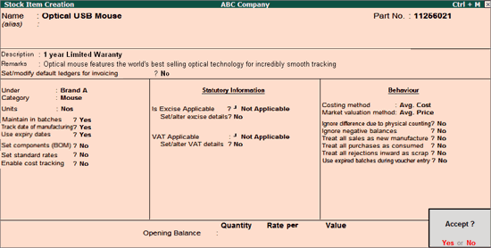

1. Go to Gateway of Tally > Inventory Info > Stock Items > Create (under Single Stock Item)
2. This Part No. field gets enabled only after enabling Use Part Number for stock items in Inventory Master Configuration. This field is used to enter the Vendors catalogue number. You can also optionally print it in reports/invoices.
3. The Description field gets enabled only after enabling Use Description for Stock Items in Inventory Master Configuration. This field is used to enter the description of the Stock Item as it is required to be printed in Quotations, Delivery Challan/Invoice.
4. This Remarks field gets enabled only after enabling Use Remarks for Stock Items in Inventory Master configuration. This field is used to enter Remarks for the Stock Item (for internal use only). Any additional details about the Item can be entered here.

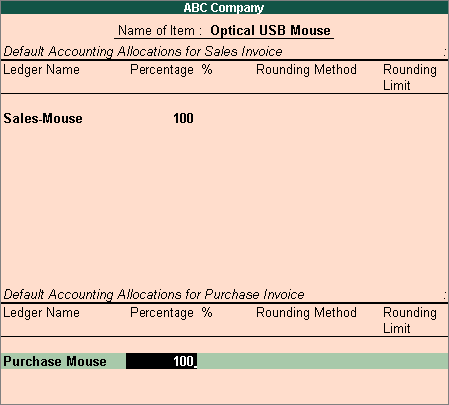

5. Set/modify default ledgers for invoicing? : This option gets enabled only after enabling Specify Default Ledger Allocation for Invoicing in Inventory Master Configuration. Once you enable this option, a  screen will be displayed for selecting the default ledger allocation for sales and purchase for the stock item.
Note: This option is useful only in case of Invoice entry through Voucher Class.

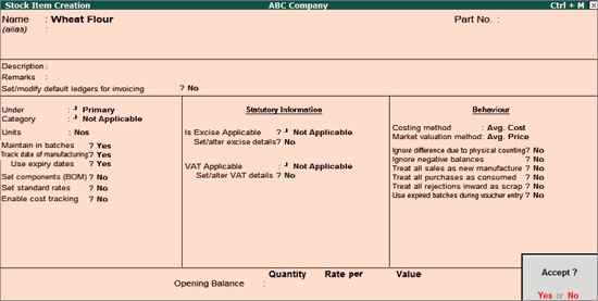

7. Alternative Units are individual units similar to simple units, which can be used instead of another simple unit during Invoicing / voucher entry and are also useful in displaying the stock reports alternatively in another simple unit. This is particularly useful when you need to handle different units at different times. This Alternate Units field gets enabled only after enabling Use Alternate Units for Stock Item in Inventory Master Configuration.
For example:
Wheat Flour bag of 1 Kgs can be sold in Nos and the weekly /monthly sale or tonnage of wheat flour can be measured in Kgs or vice versa. Here, in this both Nos and Kgs are simple units, which can be alternatively used.

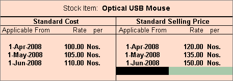

o The option Set standard rates gets enabled only after enabling Allow Std. Rates for Stock Items in Inventory Master Configuration. This option helps you specify standard purchase rate and standard sales rates for the item.
The standards are effective from the specified dates and they continue to be used at these rates until the next date, where the standard rate changes.
Note: Standard Rates can also be used for valuation of closing stock.
o The option Behaviour Group is enabled once you enable Allow Advanced Entries in Masters option. Options available under Behaviour Group are:
