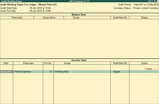

W : Working Note
Click W : Working Note or press Alt+W to specify the working note details at Company or Group or Ledger or Voucher level. The details provided in working note will be captured in Audit Working Paper along  with the details of User Name , Working Note Date and Time , Status , Note and so on.
Ctrl+W: Audit Wkg Paper
To view the Audit Working Paper during Auditing, click Ctrl+W : Audit Wkg Paper or press Ctrl+W . The details displayed in Audit Working Paper will be relevant to report from where it is triggered.
For more details on Working Paper refer the topic Audit Working Paper .
