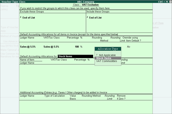

In the Voucher Type Class screen that gets displayed,
  1. In the section - Default Accounting Allocations for all items in invoice (except for the item specified below), select the sales ledger in the Ledger Name column. Select the VAT/Tax class in the VAT/Tax column. Enter the percentage as 100%.
  2. In the second section, set the option Default Accounting Allocations for to Stock Items. The option can also be set to VAT Commodities or Not Applicable, as per requirement. When Stock Items is set as the Allocation Type is selected, all stock items will be displayed. When VAT Commodities is selected, all VAT Commodities will be listed
  • Select the stock item in Name of Item/Ledger Name column
  • Select the sales ledger which needs to be allocated to the stock item
  • Select the VAT/Tax Classification for the sales ledger, for e.g. Sales @ 5.5%. Enter the Percentage as 100%
  • Similarly, select another stock item with sales ledger, VAT/Tax class, for e.g. Sales @ 14.5% and enter the percentage as 100%
