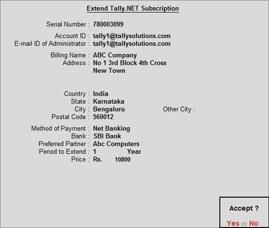

The Extend Tally.NET Subscription form appears
  • Enter the Billing Details as required
Method of Payment - TallyCurrency
  • In Method of Payment field, select Tally Currency from List of Payment Methods
  • By default, the Period to Extend is set to 1 Year
  • Based on the Edition activated the rate of subscription appears in Price field. By default the Tally.NET subscription for Multi-User and Single User Edition is set to Rs. 21600/- and 7200/- respectively.
  • Enter the required TallyCurrency Key in TallyCurrency Key field

Method of Payment - Net Banking
  • In Method of Payment field, select Net Banking from List of Payment Methods
  • In the Preferred Partner field, select the required partner from the List of Partners displayed or you can also search for a preferred partner based on the name or location.
  • By default the Period to Extend is set to 1 Year
  • Based on the Edition activated the rate of subscription appears in Price field. By default the Tally.NET subscription for Multi-User and Single User Edition is set to Rs. 21600/- and Rs. 7200/- respectively.
  • Press Enter or Y to save the details and trigger to the respective Bank website
  • Specify the required details and complete the purchase transaction
Note: Net Banking facility from this screen is available only from Release 4.7. Users using Release 4.61 or lower should select Credit Card option in the Method of Payment field of this screen and then select the Net Banking facility from the web page that appears subsequently.
On successful payment, the Invoice cum Delivery Note appears.
On successfully extending the Tally.NET Subscription, the new date appears against Tally.NET subscription valid till in License block of the Info Panel.
