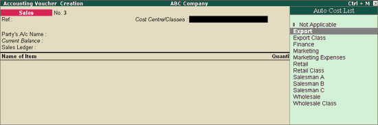

In sales, let us select Export as the Cost Centre Class.
  • Go to the Voucher Entry Screen
  • Select F8: Sales
You have the following options:
 Cost Centre Class
Select one of the classes created earlier, in this case Export.
Now enter the sales invoice. The cost centre allocation sub-screen will not be displayed but the allocation will be done automatically.

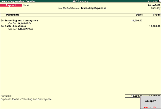

Similarly, when you press F5: Payment, similar options are displayed. Select Marketing Expenses in that case. The cost centre allocation sub-screen will not be displayed but the allocation will be done automatically.

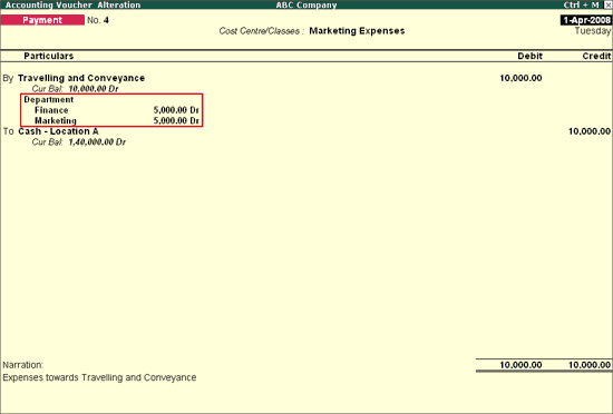

Use PgUp to check the entry in alteration mode. It will display the allocation in the voucher.
Check the cost centre reports for allocation.
