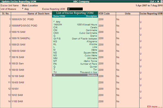

i. Excise Unit - wise
Excise Unit-wise update allows to define the Reporting UOM to all the excise Stock items of the Excise Unit.
To update reporting UOM, In Select Excise Unit screen
  • Name of Excise Unit: If company has more than one excise unit select the appropriate Excise Unit from the List of Excise Units to update the Reporting UOM to the stock items belonging to the excise unit selected. if in the company has only one excise unit then that excise Unit name will be displayed by default.
  •  Name of Tariff: Select Any from the list
  • Name of Base Units: Select Any from the list and press enter to view Update Reporting UOM screen
Note: Here Name of Tariff and Name of Base Units are set Any, because ABC Company wants to view all the excise stock items of the excise unit.
The Update Reporting UOM screen is displayed as shown:
Observe, the Update Reporting UOM screen displays all the stock items created under the Excise Unit - ABC Company.
In real business scenario an excise dealer may be dealing in excise stock items having same reporting UOM or different reporting UOM.
  • If all the items created in the excise unit have single Reporting UOM then, in Reporting UOM field select the applicable Unit of Quantity from the Units list
Example: For all the excise Items of ABC company Unit of Quantity is U (numbers) then select No. In Reporting UOM field and press Ctrl + A (short cut key to save the changes) or press Enter till you reach Accept Yes or No option.
On accepting Update Reporting UOM screen, The unit of measurement No. (U) will be updated as the Reporting UOM to all the Excise Items.

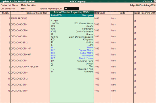

iii. Base Unit-wise
Base Unit-wise update allows to define the reporting UOM to the excise Stock items grouped under the specific Base Unit.
  • Name of Excise Unit: If company has more than one excise unit select the appropriate Excise Unit from the List of Excise Units to update the Reporting UOM to the stock items belonging to the excise unit selected. if in the company has only one excise unit then that excise unit name will be displayed by default.
  •  Name of Tariff: Select Any from the List of Tariff Classifications.
  • Name of Base Units: To update the Reporting UOM of stock items with specific base unit, select the Base Unit from the Units list. E.g. ABC Company wants to update the Reporting UOM of the stock items with base unit - Mtrs.
  • Press Enter to view Update Reporting UOM screen
The Update Reporting UOM screen appears as shown
In Update Reporting UOM screen, application displays only those stock items with the base unit Mtrs.
  • If all the items with specific base unit have single Reporting UOM then, in Reporting UOM field select the applicable Unit of Quantity from the Units list
Example: For all the excise Items with Base Unit Mtrs, Unit of Quantity is KG (kilogram) then select Kg in Reporting UOM field and press Ctrl + A (short cut key to save the changes) or press Enter till you reach Accept Yes or No option.
  • If the stock Items with specific base unit have different Reporting UOM then, in Reporting UOM field select Any from Unit list. Update Reporting UOM only to those stock items where ever there is discrepancy and retain the Reporting UOM of other items intact.
To define the Reporting UOM to Stock item press Enter cursor will move to Reporting UOM column, select the stock item and define the Reporting UOM.
Press Ctrl + A (short cut key to save the changes) or press Enter till you reach Accept Yes or No option to save the changes.
Similarly, user can select to update Reporting UOM to stock items with other Base Units.
