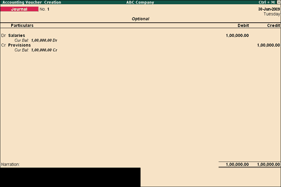

Consider an example: it is the 30th of June and you would like to view the Balance Sheet as of today, but June salaries are not due for payment until the first week of July.  The Balance Sheet will not be projecting the correct figures. To overcome this, you can enter an Optional Voucher dated 30th June.
  1. Debit Salaries Account
  2. Credit Provisions (Current Liabilities) Account
When you view the Balance Sheet, generate a report with the Optional Voucher included. The Optional Voucher should be already defined as a Scenario (Refer the section on Scenario Management for more details). The voucher affects the report temporarily. Once you quit the report, Tally.ERP 9 does not retain the Scenario details. The next time you view the balance sheet, it will not include the effect of the Optional Voucher unless you include it.
