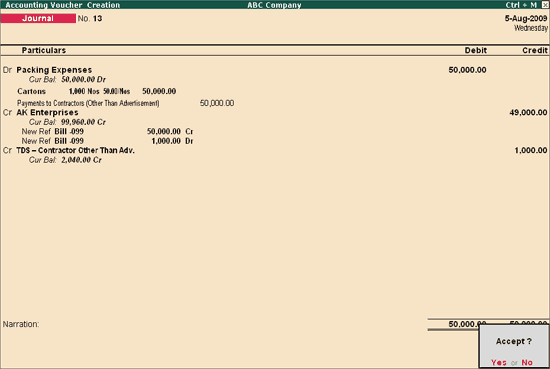

 Step 5: Create Journal Voucher
Go to Gateway of Tally > Accounting Vouchers > Press F7:  Journal
  1. Press F2 and change the date to 05-08-2009
  2. In the Debit field select Packing Expenses ledger from the List of Ledger Accounts and press enter to view Inventory Allocation screen
  3. In the Inventory Allocation Screen
  4. In the Name of Item field select Cartons
  5. In the Quantity field enter 1000
  6. Enter Rs. 50 in the Rate column and the Amount is displayed automatically
  1. In TDS Nature of Payment  Details screen accept the default details.

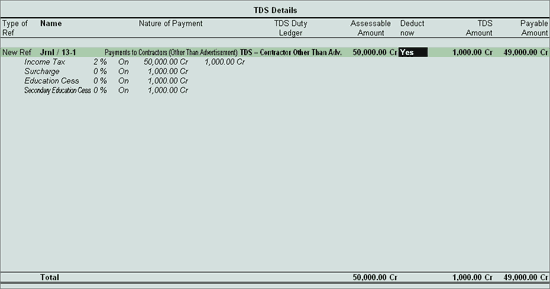

  2. In the Credit field select AK Enterprises and press enter to view TDS Details screen
  3. In the TDS Details screen
  4. In the Type of Ref field select New Ref
  5. In the Name field Jrnl / 13-1 is displayed automatically
  6. In the Nature of Payment field select Payment to Contractors ( Other Than Advertisement)
  7. In the TDS Duty Ledger field select TDS- Contractor Other Than Adv.
  8. Set the Deduct Now field to Yes
  9. TDS Amount field displays the Tax amount Deducted at Source
  10. Payable Amount field displays the amount (after TDS) payable to the party
  1. Press Enter to accept the TDS Details.
  2. Payable Amount as calculated in the TDS Details screen will be defaulted in the Party’s Amount (Credit) field.
  3. In Bill-wise Details screen
  4. Select New Ref as the Type of Ref
  5. In the Name field enter the Bill name as Bill -099
  6. Skip the Due Date or Credit Days field
  7. Accept the default amount allocation and Dr/Cr. By default Tally.ERP 9 displays the Bill amount in the amount field as the credit balance.
  8. Press Enter, select New Ref as Type of Ref and enter Bill name as Bill -099
  9. Skip the Due Date or Credit Days field and accept the default amount allocation and Dr/Cr. By default Tally.ERP 9 displays the Tax amount in the amount field as the debit balance.
  1. In the Credit field select TDS- Contractor Other Than Adv. from the List of Ledger Accounts.
  2. In the Amount field, Rs. 1000 [Bill amount (50,000) – Pending Amount (49,000)] is displayed automatically.
  3. Enter Narration, if required.
  1. Press Enter to save.
