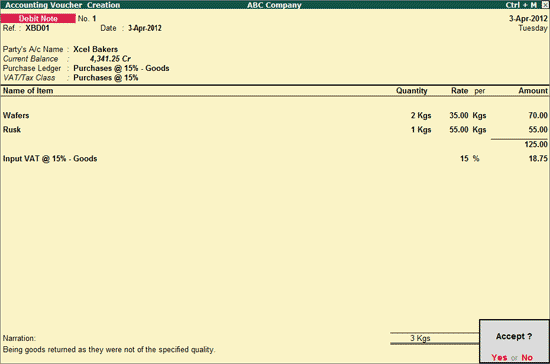

To create a Debit Note for Purchase Returns,
Go to Gateway of Tally > Accounting Vouchers > Ctrl+F9: Debit Note
  1. Enter the reference number in the Ref field. The invoice date will automatically be entered in the Date field and this can be changed if required.
  2. Select the Party’s A/c Name from the List of Ledger Accounts.
  3. Select the required Purchase Ledger and the appropriate VAT /Tax Class appears.
  4. Select the Name of Item from the List of Items.
  5. Enter the Quantity and Rate.  The amount is automatically displayed in the Amount field.
  6. Similarly, select another item and enter the Quantity and Rate. The amount will be automatically calculated and displayed.
  7. Select the required Input VAT ledger from the List of Ledger Accounts.
  8. Enter the details in the field Narration, if required.
