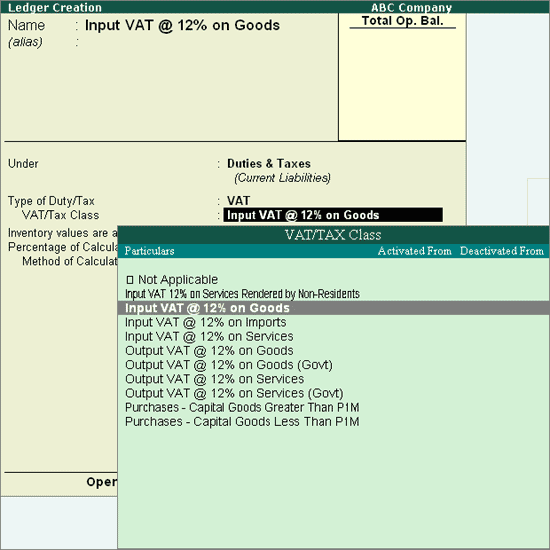

To create a Input VAT Ledger
Go to Gateway of Tally > Accounts Info > Ledger > Create
  1. Enter the Name of the ledger, for e.g., Input VAT @ 12% on Goods
  2. In the Under field, select the Duties & Taxes from the List of Groups
  3. Select the Type of Duty/Tax as VAT from the List of VAT/TAX Class
  4. Select the required  VAT/Tax Class, for e.g., Input VAT @ 12% on Goods from the VAT/Tax Class list
  1. The option Inventory values are affected will be set to No by default
  2. The Percentage of Calculation will be set based on the VAT/Tax Class selected, for e.g., 12%
  3. The Method of Calculation will be automatically set to On VAT Rate
  4. Accept the screen to save.
Note: If the VAT/Tax Class is not selected at the ledger level, the same can be selected during voucher entry.
