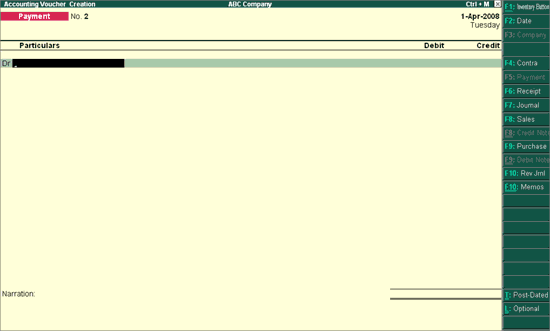

This is also a non-accounting voucher, but unlike a  Memo voucher. This is not a separate voucher type. You can mark an existing voucher (for example, a payment voucher or a receipt voucher) as Optional. Press CTRL + L or click on Optional from the Button Bar. This button toggles with Regular. By marking a voucher Optional, the voucher does not get posted anywhere but remains in the Optional Register.
You can make a voucher type default to Optional if you need to create a new voucher type or alter an existing voucher type (Go to Gateway of Tally > Accounts Info > Voucher Types> select a Voucher Type> Set Make Optional as default to Yes).

On 30th June you want to view the Balance Sheet as of that date, but June rent is not due for payment until the first week of July. This liability is not reflected in the Balance Sheet. To overcome this, enter an Optional Voucher dated 30th June. The above entry is made as shown:
Click on Optional or Ctrl+L to make the voucher as Optional Voucher
Pass the entry as shown:
Debit – Rent Account
Credit – Cash/Bank Account

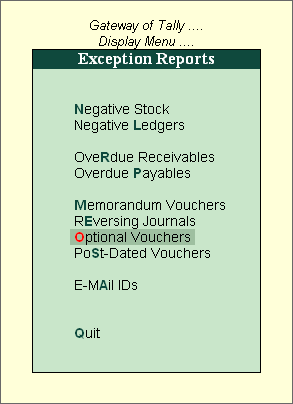

Optional Vouchers Register
You can view all optional vouchers in the Optional Vouchers Register.
Go to Gateway of Tally > Display > Exception Reports > Optional Vouchers.
Note: You can view them from the Day Book as well.
