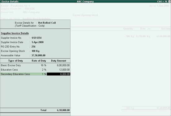

  1. Press Enter from Amount field to view Excise Details screen
  1. Enter the Supplier Invoice Number and Supplier Invoice Date
  2. Enter the PLA RG 23 Sl. No. if any
  3. Enter the Quantity on hand in the field Excise Opening Stock and accept the Excise Dealer sub form
  4. In Assessable Value field enter the amount on which the manufacturer has paid the duty while removing the goods. Here Sterling Steel Industries have paid duty on the assessable value of 37,50,000. Hence the manufacturer assessable value has been entered for appropriate duty calculation.
Note: For accurate Duty calculations, all the fields in the above screen have to be accepted.
  1. Press Enter to accept the screen.
