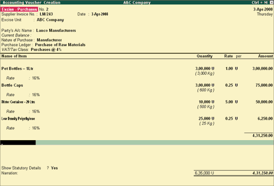

Go to Gateway of Tally > Accounting Vouchers > F9: Purchases
  1. In Voucher Type sub form select Excise – Purchases as the voucher type.
  2. Ensure that the Purchase Voucher is in Item Invoice Mode.
  3. Enter the Date as 3-4-2008.
  4. In Supplier Invoice No. field enter the Invoice No. as LM/243.
  5. In Party’s A/c Name field select the supplier i.e. Lanco Manufacturers from the List of Ledger Accounts (Use Alt+C to create the party ledger).
  6. In Nature of Purchase field the option Manufacturer is displayed automatically
  7. In Purchase Ledger field select the ledger Purchase of Raw materials from List of Ledger Accounts.
  8. VAT/Tax Class field automatically gets updated with the VAT/Tax class as selected in the purchase ledger, which can be changed.

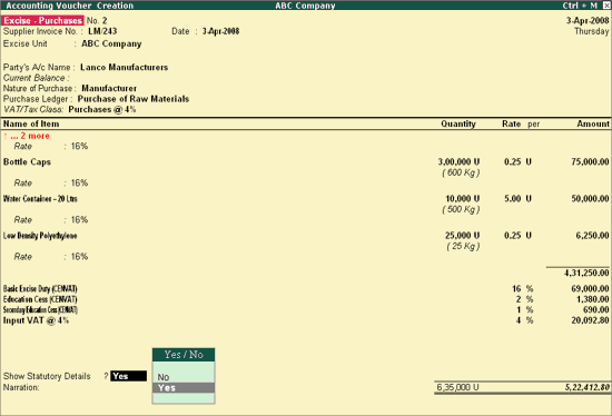

  9. In Name of Item field select the Stock Item i.e. Pet Bottles – 1 Ltr.
  10.  In Quantity field enter the quantity as 3,00,000.
  11. In Rate field enter the rate as Rs. 1.
  12. Amount will be displayed automatically.
  13. Select Bottle Caps as second item and specify Quantity as 3,00,000  and Rate as Rs. 0.25.
  14. Select Water Container – 20 Ltr as third item and specify Quantity as 10,000 and Rate as Rs.5.
  15. Select Low Density Polyethylene as fourth item and specify Quantity as 25,000 and Rate as Rs.0.25.

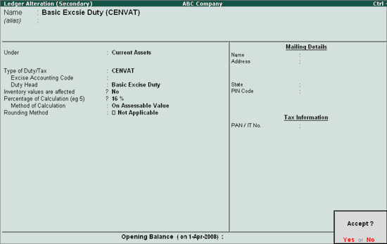

  1. Select Duty Ledger i.e. Basic Excise Duty (CENVAT) (use Alt + C to create the ledger). Duty ledger creation appears as shown.
Note: To avail Cenvat Credit, create the ledgers under Current Assets by selecting duty/tax type as CENVAT in the Type of Duty/Tax field.
  1. Amount for Basic Excise Duty (CENVAT) will be displayed automatically.
  2. Select duty ledger Education Cess (CENVAT) (use Alt +C to create the ledger).
Refer Creating Education Cess Ledger for more information
  1. Select duty ledger Secondary Education Cess (CENVAT) (use Alt + C to create the ledger).
Refer Creating Secondary and Higher Education (SHE) Cess Ledger for more information
Note: select Type of Duty/Tax as CENVAT for all the Duty ledgers created to avail Cenvat Credit. These duty ledgers are used only during accounting purchases.
  1. Select Input VAT @ 4% as the Vat duty ledger. Amount will be displayed automatically.

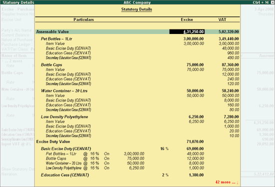

  2. Set the option Show Statutory Details to Yes to view Statutory Details screen.
  1. In Statutory Details screen press Alt + F1: Detailed to view details of duty calculation. Statutory Details screen is displayed as shown.
Note: In statutory details user can view Item/ ledger wise assessable value and Duty/Tax calculation.

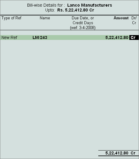

  1. In Bill-wise Details screen select Type of Ref as New Ref and in other fields retain the default details.

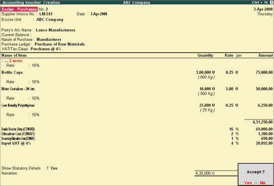

  1. Enter the Narration, if required.
  1. Press Enter to save and accept.

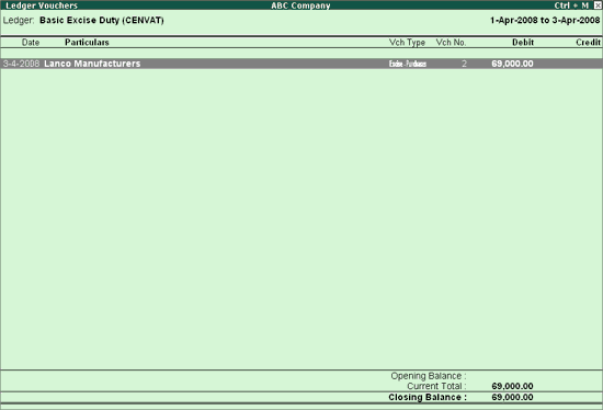

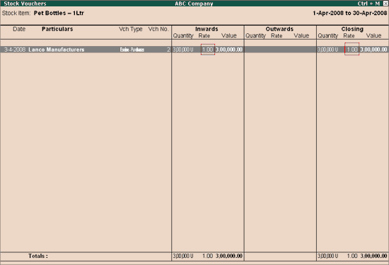

When the CENVAT Credit is availed the Duty Ledgers selected will display the ledger balance and duty amount will not be apportioned to the Stock Item Rate.
To check the duty ledger balance
Go to Gateway of Tally > Display > Account Books > Ledgers > select Basic Excise Duty (CENVAT).
 To view the non- apportionment of duty amount to stock item Rate:
Go to Gateway of Tally > Display > Inventory Books > Stock Item > Pet Bottles – 1 Ltr > Stock item Monthly Summary > Stock Vouchers
In F12: Configure
  • Ensure that the option Show Rates is set to Yes.
Observe, in Stock Vouchers report stock item rate is displayed as Rs.1 which is the actual purchase rate. In this case the duty amount is not apportioned to the Stock item.
