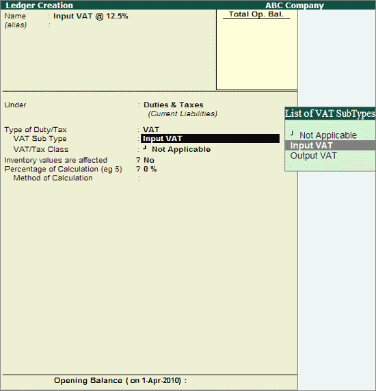

Input VAT Ledger
Go to Gateway of Tally > Accounts Info. > Ledgers > Create
  1. Enter the Name as Input VAT @ 12.5%
  2. Select Duties & Taxes as the group name in the Under field
  3. Select VAT from the Type of Duty/Tax list in the field Type of Duty/Tax
  4. Set the VAT Sub Type as Input VAT
  1. Select Input VAT @ 12.5% in the VAT/Tax Class field from the VAT/Tax Class list displayed
  1. The option Inventory values are affected is set to No by default as it is a VAT ledger
  2. The Percentage of Calculation and Method of Calculation will be displayed based on the VAT/Tax Class selected
Similarly create a ledger for input VAT on imports by selecting the VAT/Tax class - Input VAT @ 12.5% on Imports.
