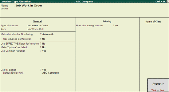

Step 1: Alter Job Work In Order Voucher Type
Go to Gateway of Tally > Accounting Info. > Voucher Types > Alter > Job Work In Order
  • Tab Down to Use for Excise field and set this option to Yes
  • In Default Excise Unit field select ABC Company from the List of Excise Units.
