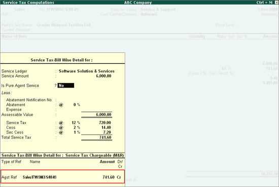

While recording Service Tax transactions if the Reference number used in one financial year is used again to account the sale of services in another financial Year, for reference number selected while recording transaction the reference will be displayed as New Ref. On saving the voucher application cross refers the references available in the data and if the similar tax reference is found in any other transaction recorded then the reference will be turned to Agst Ref.
The transactions with the tax reference as Agst Ref will not be reflected in the Service Tax Payable report, viewed in Release 1.61 or lower versions because the transactions with the tax reference - Agst Ref will get knocked off against the transaction with tax reference - New Ref.
From un- migrated vouchers report select the party and press enter to view the Track migrate vouchers report.
Select the sales voucher which is not migrated and press enter to view the Accounting Voucher Alteration (Secondary). Select the service tax ledger and press enter to view Service Tax-Bill Wise Details screen.
Observe in the above screen shot the Service Tax Bill Details displays the Reference as Agst Ref. These types of vouchers will not get migrated.
Solution:
From Ledger Vouchers report (Go to Gateway of Tally > Display > Account Books > Ledgers > select the party ledger from the List of Ledgers) select the voucher (purchase/Sales) and press enter to view the Accounting Voucher Alteration (Secondary) screen.
In Accounting Voucher Alteration (Secondary) screen select Service Sale or Purchase Ledger and press Enter to view Service Tax Details screen
In Service Tax Details screen, enter the service amount in Service Amount field Service Tax gets calculated accordingly. Save the Voucher alteration
After saving the voucher, this voucher will not be displayed in Un-Migrated Vouchers report. It gets migrated automatically.
After correcting the Sales/purchase voucher, alter the receipt or payment vouchers recorded in connection with the sale or Purchase by providing the tax reference number provided in earlier altered sales/ purchase voucher. After alteration save the receipt or payment voucher.

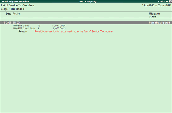

Case 8: Credit Note/Debit Note Tax reference cannot be New Ref
This reason will be displayed in two cases
1. Service Sales changed to credit Note.
2. Service Sales partially/wholly reversed through Credit Note and later the original Service Sales is deleted.
Observe in the above screen shot the Service Tax Bill Details displays the Reference as Agst Ref. The option Agst Ref will be taken, only when a sales or purchase voucher is changed to Credit Note or Debit Note.
In this scenario user has changed the sales voucher type to credit Note. These types of vouchers will not get migrated.
Solution:
Change the Debit/Credit Note to Journal voucher and save the voucher.

Case 9: Credit/Debit Note Bill Ref (s) is not linked to Sales / Purchase Voucher
This reason will be displayed when Service Sales/Purchases are partially/wholly reversed through
Credit/Debit Note and later the original Service Sales/Purchase Voucher is deleted.
Solution:
If the user wants the proper report and transactions to be displayed in data, Identify the sales/
purchase voucher and link the same to the Credit/Debit Note.
To select the Sales/Purchase Voucher Bill Reference,
Select the Credit/Debit Note Voucher and press Enter to view Accounting Voucher alteration (Secondary) screen and tab down to view Bill-wise Details screen
In Bill-wise Details screen
In Type of Ref field by default New Ref will be displayed. Select Agst Ref from the Method of Adjustments
In Name field select the appropriate Sales Bill Reference - Bill-004 from the Pending Bills
Retain other details and save the Bill details and Credit Note
Observe, now in the Track Migrate Vouchers report you can see the relevant Sales Voucher along with Credit Note.
If the users select the Bill Reference Number and presses F7 to Migrate, Tally.ERP 9 will not migrate the transactions. Because when the data was migrated sales voucher was migrated where as Credit note was not. Hence system is not able to follow the instruction of F7: migrate to migrate the Vouchers
To correct this go to Day Book,
Select the appropriate Sales Voucher to alter.
Tab Down to Sales Ledger and press Enter to view Service Tax Details Screen
Service Tax Details screen displays the Service tax details as the voucher is already migrated. In this screen, in Type of Ref field select End of List as the Method of Adjustment to clear the details in the Service Tax Details. On selecting End of List application comes out of Service Tax Details screen.
Press Enter to Save the Sales Voucher.
On correction come back to Track Migrate Vouchers report, now you can see that the sales voucher is also considered as un-migrated voucher.

Case 10: Possibly transaction is not passed as per the flow of Service Tax Module
This message will be displayed to those transactions which do not fall under any of the above reasons discussed.
Solution:
To migrate the vouchers with the reason Possibly transaction is not passed as per the flow of Service Tax Module
Select the Reference Number (to select move the cursor on the reference number and press space bar. Transaction will be highlighted with green colour), then press F7 or click on F7: Migrate to migrate the vouchers.
Note: Most of the transaction will migrate when the solution given above is followed. If vouchers are not migrating then manually check the vouchers and correct the vouchers as per the flow of earlier service tax module.
