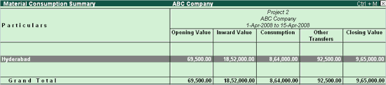

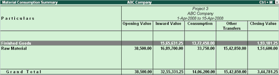

To view the Material Consumption Summary report, scroll down to the line Consumption in Job Work Analysis Report and press Enter.

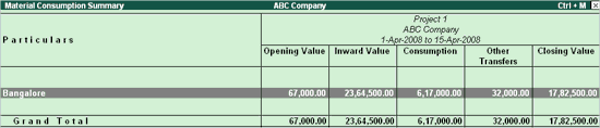

The Material Consumption Summary report is displayed.
Here it will display Opening Value, Inward Value, Consumption, Other Transfers and Closing Value.
It will display the Godown of the particular Job/Project:

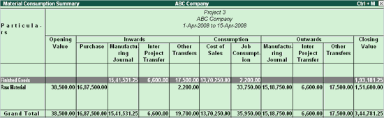

Detailed view of  Inward Value, Consumption and Other Transfers:

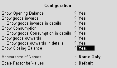

Press F12 and set  Show goods inwards in detail, Show goods Consumption in detail and Show goods outwards in detail to Yes.
Material Consumption Summary will appear as below:

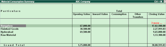

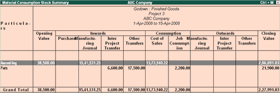

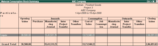

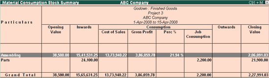

Further drill down from Material Consumption Summary to Material Consumption Stock Summary, would enable the user to view the Stock Group:
This Report displays the material consumed for the Job/Project. Details of Opening value, Inward Value, consumption, other transfers and Closing value is shown – Drill down:

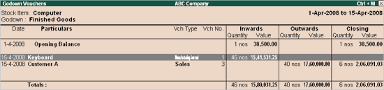

Drill down from the above report, will display the Stock items used for Job/Project
Drill down further to display the Godown Voucher screens.
It displays the report godown wise - Inwards, Outwards and Closing Balance.

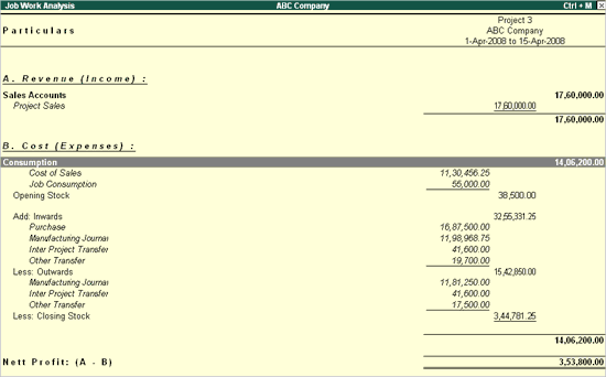

To view total material consumption of all the Job/Projects

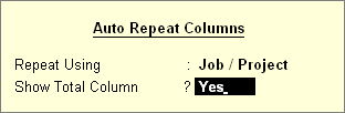

The button Auto Column is available to view all the Job/Projects material consumption report in one sheet. Press Alt+N.
For comparison of one Job/Project material consumption with other Job/Project.

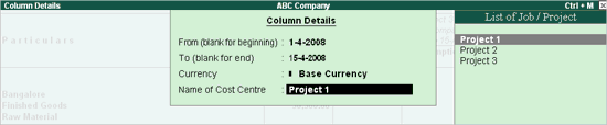

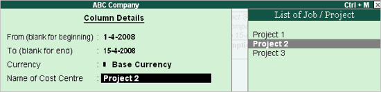

The button New Column is also available in the report to view the period for a particular period that can be selected from the list – Press Atl+C
Viewing other Job/project from the screen on one Job/Project:
The button Alter Column is also available in the report to view the other job or Project. Press  Alt+A
F4 button:
Click this button to select the other Job/Project from the list.

Profit button is available in the Material Consumption Stock Summary report, to view the Gross Profit with Percentage for a particular Job/Project.
