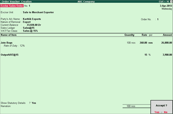

Step 2: Record Sales Order
Go to Gateway of Tally > Order Vouchers  > F5: Excise Sales Order
  1. Enter the Date as 3-4-2013
  2. The Excise Unit field will be pre-filled with the Excise Unit selected while creating the Excise Sales Order voucher
  3. In Party A/c Name field select Karthik Exports from the List of Ledger Accounts

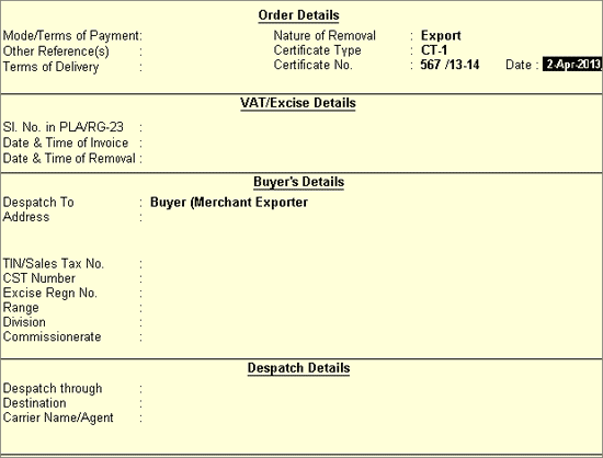

  4. In the Party Details screen,
  5. select  Nature of Removal as Export, and select CT-1 in the Certificate Type
Note: CT-1 will be issued by the merchant exporter to the manufacturer.
  • Enter CT-1 number and Date
  • Enter Buyer's Details and Despatch Details as required
  1. In the Voucher entry screen, enter the Order No.
  1. Select the required Sales Ledger
  2. Select the item being sold, that is, Jute Bags
  3. In the Stock Item Allocations screen, enter details of quantity (100 nos.) and rate (Rs. 260). The amount will be calculated automatically.
  4. Enable the option Show Statutory Details, if you want to view the duty details
The complete sales order entry is displayed as shown:
  1. Press Enter to save

  9. Enter the required details In Party Details sub-screen
  10. Set Nature of Removal to Export
  • Select Certificate Type as CT-1. Fill in other field under VAT/Excise Details as is necessary
  • Under Despatch Details, select the Tracking Number for the relevant Delivery Note, if any. Fill in other details as is necessary
  • Under Order Details, Select the relevant Order Number. The Certificate Number, if entered while raising the Sales Order, will be captured here. Fill the other details as required
Note: Incase the user has not recorded an Excise Sales Order, then while recording an Excise Sales entry, after selecting the Nature of Removal as Export and CT-1 as the Certificate Type, the option New Number needs to be selected for Order No(s), and a provision will be available for specifying CT-1 number and date. These details are captured on Rule 11 Invoice.
  • Accept the screen

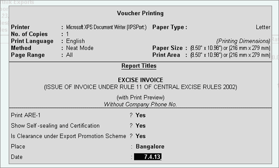

Printing Rule 11 Invoice
To print Rule 11 Invoice,
In the Voucher Printing screen, set Print ARE-1 to No.
The print preview will appear as shown:
Note: The ARE-1 number and CT-1 number and date of issue of the CT-1 will be captured in Rule 11 invoice.
Printing Form A.R.E. 1
From the Voucher Alteration screen, press Alt+P
The Voucher Printing screen appears:
  1. Set Print ARE-1 to Yes
  2. Enable the other options if required
  3. Fill in the place and date of generating ARE-1.
Note: (i) If the goods are dispatched under ‘Self Sealing and Certification’, then the same needs to be certified accordingly. Hence the need to enable the option Show Self-sealing and Certification. Otherwise this option is set to No
       (ii) Incase if the manufacturer would like to mark the ARE-1 with the details as ‘Export under EPCG / Advance License’ scheme then the option Is Clearance under Export Promotion Scheme has to be set to Yes
Form A.R.E. 1 will be printed as shown:
