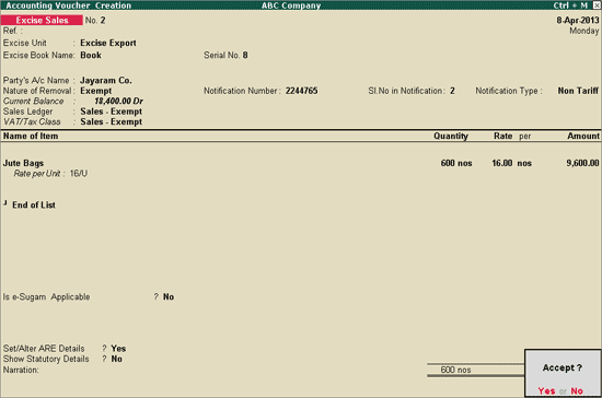

Step 3: Record Excise Sales Invoice
Go to Gateway of Tally > Accounting Vouchers  > F8: Sales
  1. In Voucher Type sub-screen select Excise – Sales
  2. Ensure that the Sales Voucher is in Item Invoice mode
  3. Enter the Date as 8-4-2013
  4. Enter reference number, if any, in the Ref field
  5. The Excise Unit field will be pre-filled with the Excise Unit selected while creating the Excise Sales voucher
  6. Excise Book Name field displays the name of the excise invoice book created for the Excise Unit
  7. Serial No. field displays the Rule 11 invoice Number
  8. In Party A/c Name field select Jayaram Co. from the List of Ledger Accounts
  9. In the Party Details screen, select  Nature of Removal as Exempt, and select CT-3 in the Certificate Type
  1. Enter the required details in other sections of the Party Details screen
  1. The option Nature of Removal in the Voucher Creation screen will be set to Exempt
  1. In Notification Number field enter the notification under which the goods are exported. If the Notification number is specified while creating the party ledger application will capture the details from party ledger
  2. In Sales Ledger field select the sales ledger Sales - Exempt from the List of Ledger Accounts
  3. The VAT/Tax Class will automatically be set to Sales - Exempt, if the same is configured in the Sales Ledger
  4. In Name of Item field select the Stock Item i.e. Jute Bags
  5. In the Quantity field enter the number of units being exported. That is, 600 nos.
  6. In Rate field enter the rate as Rs. 16. Amount will be calculated automatically
  1. Enable Set/Alter ARE Details. Enter the details as required in the Form ARE Details sub-screen:
  1. Enable the option Show Statutory Details, if you want to view the duty details
  1. Press Enter to accept the screen and return to Voucher Creation screen
The completed entry appears as shown:
  1. Press Enter to save
