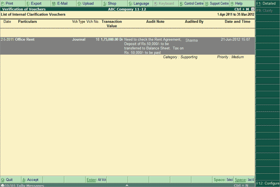

  • The List of External Clarification Vouchers screen displays the Voucher details for which the Clarification is asked by the Auditor along with the Audit Note and Name of the Auditor (Audited By).
The List of Internal Clarification Vouchers screen displays the Voucher details for which the Clarification is asked by another user within the organisation along with the Audit Note and Name of the User (Audited By).

Click on F9: Clarify button or press F9 key provide the necessary Clarification to the Auditor. The Clarification process is explained below in detail.
Provide Clarification
To provide the necessary Clarification go to the line where the Audit remarks are displayed/stored and follow process given below:
  • Place the cursor on the Audit Note for the Voucher
  • Press Enter
Note: When Enter key is used to for Clarification, there is not need to select the Voucher by using Spacebar.
The Audit Clarification screen appears as shown:
  • Enter the required Clarification remarks and press Enter
Once the Audit Clarification is saved with the Clarification remarks, the Voucher will disappear from the Audit Vouchers screen and the same will be listed under Clarified (To be re-audited) with the Audit Status as Clarified along with the Clarification remarks.
