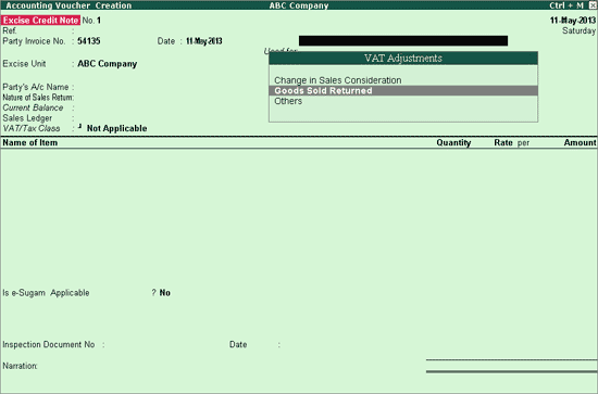

Recording the Sales Return of Goods
To account for sales returns,
  1. Go to Gateway of Tally > Accounting Vouchers > Ctrl + F8: Credit Note > Select Excise Credit Note
  2. In the item invoice mode, enter the Date
  3. In the Ref: field; enter the original Sales Invoice number against which the goods have been returned.
Note: This field has been provided for the information to be captured in VAT Returns.
  1. Enter the invoice number and date in the Party Invoice No: and Date fields.
Note: Enter the Voucher number of the Excise Debit Note or any other equivalent document sent with the goods returned in the Party Invoice No: field. If the goods have been returned with the manufacturers’ own invoice, leave this field blank and enter the number in the Invoice Date field in the Item Allocation screen in step 10.
  1. Select Goods Sold Returned in the Used For: field
  1. Select the Party Ledger in the Party’s A/c Name field
  2. Enter the Receipt, Order and Buyer Details if any

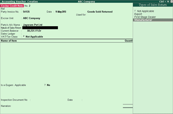

  3. In the Nature of Sales Return field, select the appropriate option.
  1. Not Applicable: This option can be selected to record a normal or non-excise credit note.
  2. Export: If this option is selected, although there was no liability to pay duty when the goods were exported, duty will have to be paid while recording the return of the goods i.e. while importing the goods. It is necessary to pay Customs Duty, CVD and Additional duty of Imports. Details of CENVAT credit will reflect in row 4, table 8 of the ER 1 Excise Form.
  3. First Stage Dealer: If this option is selected, details of CENVAT credit will reflect in row 3, table 8 of the ER 1 Excise Form.
  4. Manufacturer: If this option is selected, details of CENVAT credit will reflect in row 2, table 8 of the ER 1 Excise Form.

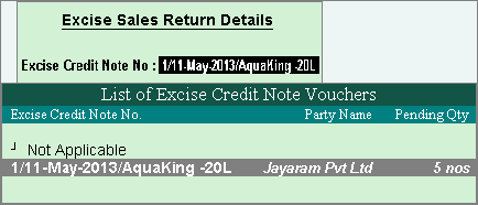

Sale of Goods Returned (No Manufacturing Process Involved) - Removed As Such
In the Excise Sales invoice,
  1. Select the party ledger in Party’s A/c Name field.
  2. Enter required details in the Party Details screen.
  3. Select Removal as Such in the Nature of Removal field as the goods are being sold without subjecting it to manufacturing process
Note: It is necessary to select the Removal as Such flag to select the goods from the list of Credit Notes recorded for return of goods
  1. Select the Sales Ledger and the VAT/Tax classification
  2. After the Stock Item  is selected, the Item Allocation screen will be displayed
  3. From the list of credit notes displayed for selection choose the relevant Excise Credit Note
Note: Only if the Nature of Removal is chosen as Removal as Such and the stock item is a finished product, the list of credit notes will be displayed for selection.
  1. Based on the selection made, the credit note details will be displayed in the item allocation screen
  1. Enter the quantity. The Rate and total amount will be automatically calculated and displayed.
  1. Select the excise duty Ledger predefined with Type of Duty Excise and VAT Ledgers. Press Y or Enter to accept and save.
  1. The quantity of goods so sold, will be captured in the Rule 11 Invoice and RG 23 part I report.
