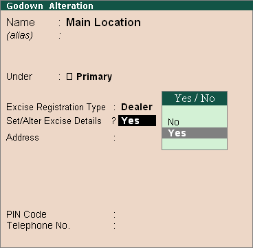

Step 2: Configure the Godown as Excise Dealer Unit
To configure the Godown
Go to Gateway of Tally > Inventory Info > Godowns > Alter
  1. From the List of Godown, select the required Godown that has to be treated as Excise Dealer Unit. The selected Godown should be under Primary.
  2. In Excise Registration Type, select as Dealer from List of Registration Types.
  3. Set the option Set/Alter Excise Details to Yes, to enter excise registration details
  1. Specify the required Excise Details in Excise Details screen as shown.
  1. The completed Godown Alteration screen appears as shown
Note: Similarly, you are required to alter the remaining Godowns which are under Primary.  Group the  remaining godowns under the Godown which has been treated as Excise Dealer Unit and set Not Applicable for Excise Registration Type.
