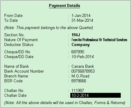

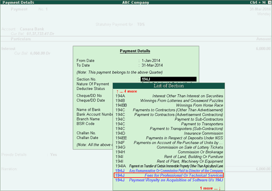

  3. In the Payment Details screen that appears,
    • Select the appropriate Section No.
    • The relevant Natures of Payment will be displayed. Select the Nature of Payment required
    • Select the Company/ Non Company, as per  Deductee Status
    • Enter Cheque/DD No and Date in relevant fields
    • Select the Name of Bank from the List of Banks displayed. Bank Account Number, Branch Name, BSR Code are auto-filled, as per the details provided in the Bank ledger selected
    • Fill in the Challan Details as required
The completed Payment Details screen is as shown below:

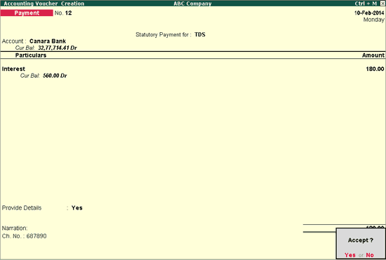

  1. Press Enter to go to the Payment Voucher screen
  2. Press Enter to accept the Voucher amount
  3. Enter the required details in the Bank Allocation screen
  4. Enter Narration, if required
The completed Payment Voucher is as shown below:
  1. Press Enter to accept

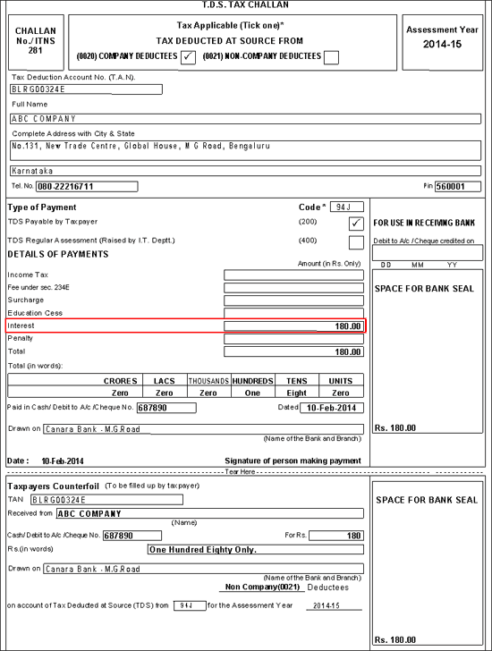

Step2: Generating ITNS 281 Challan
  1. Open the Payment Voucher in alteration mode
  2. Press Alt+P or click P: Print
  3. In the Voucher Printing screen, set the option Print as TDS Challan to Yes
  4. Save the Voucher Printing screen
  5. The preview of ITNS 281 Challan is generated. Press F4 to zoom- in
The ITNS 281 Challan appears as shown below:
You can see that the Interest Payment, thus made is captured in the ITNS 281 challan
