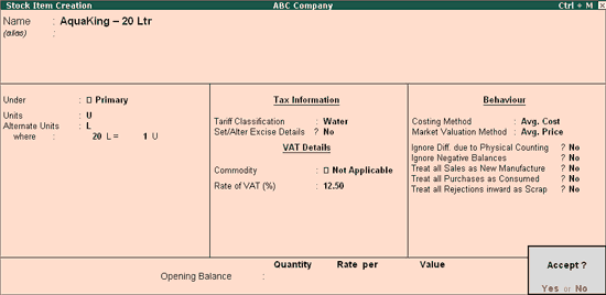

To create a Stock Item – Finished Goods,
Go to Gateway of Tally > Inventory Info. > Stock Items > Create
  1. Enter the name of the Stock Item e.g. AquaKing – 20 Ltr in the Name field.
  2. Select the Group Name e.g. Primary in the under field.
  3. Select the unit of measurement e.g. U (Number)  of the stock item in the Units field
  4. Select the unit of measurement e.g. L [Liter (s)] of the stock item in the Alternate Units field (Use Alt +C to create Unit of Measurement)
  5. Specify 20 L = 1 U in Where field.
Note: Unit and Alternate Unit details provided in the Stock item master are only for the purpose of accounting the Stock items.

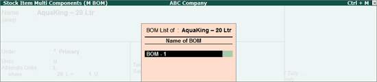

  1. Enable Set Components (BoM) to Yes and press enter to view Stock ltem Multi Components (M BOM) screen
Note: The Bill of Material (BOM) details provided here will be used for Production of the stock Item.
  1. In Stock ltem Multi Components (M BOM) screen
  2. In Name of BOM field enter the BOM name
Note: In Tally.ERP 9 you can create Multiple BOM for a single finished goods. This feature is provided in Tally.ERP 9 Release 3.0.  For more information on creating Multiple BOM refer the topic - Creating Bill of Materials for a Stock Item

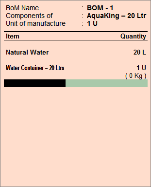

  1. In Stock ltem Components (BoM) screen
  2. In Unit of manufacture field enter as 1
  3. Under Item and Quantity field enter the details as shown

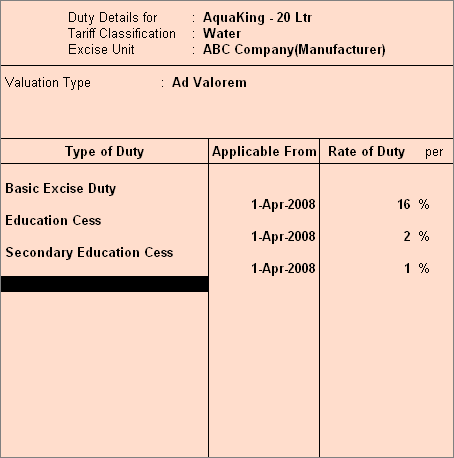

  • Set/Alter Duty Details: Set this field to Yes to view the Duty Details screen.
  • In the Duty Details screen:
  • In Valuation Type field select Ad Valorem from the List of Valuation Type
  • Select the Basic Excise Duty in the Type of Duty field from the List of  Excise Duty classifications
  • In Applicable From field mention the Date from when the specified Rate of Duty is applicable
  • Specify the Rate of Duty as 16%
  • Select the Education Cess as the second duty  in the Type of Duty field from the List of  Excise Duty classifications
  • Specify the Rate of Duty as 2%
  • Select the Secondary Education Cess as the third duty in the Type of Duty field from the List of Excise Duty classifications.
Note: Secondary and Higher Education Cess is applicable from 11-5-2007
  • Specify the Rate of Duty as  1%

  1. Rate of VAT (%): in this field enter the Rate of VAT applicable for the Stock Item e.g. 12.50%
  1. Press Enter to accept and save.
