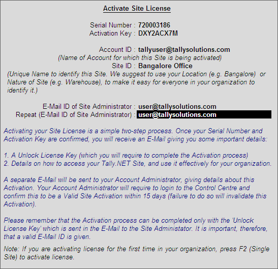

The Activate Site License form appears as shown below:
  1. Enter the License Serial Number in the Serial Number field.
  2. Enter the Activation Key in the Activation Key field.
The license Serial Number and the Activation Key are printed on the Installation Guide for Tally.ERP 9.
  1. Enter the required Account ID in the Account ID field.
Use the existing Account ID to activate the new/ subsequent sites.
  1. Enter a unique name for the site to be activated in the Site ID field. The Site ID enables you to distinguish between locations where Tally.ERP 9 is activated.
  2. Enter your valid E-Mail address in the E-Mail ID of the Site Administrator field.
The Unlock Key, Password and account related information are mailed to Site Administrator's E-Mail ID.
  1. Ensure that you re-enter the same Email ID in Repeat (E-Mail ID of the Site Administrator) for the purpose of confirmation.
  2. Press Enter to activate a Multi-Site Account.

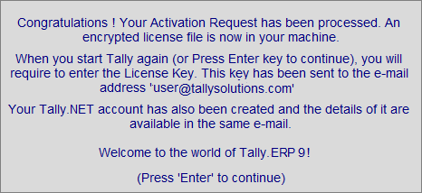

Tally.ERP 9 displays the following message indicating the activation request has been processed.
  • The Tally_lck.lic file is generated and resides in the default Tally.ERP 9 folder
In order to get the license, the locked license file has to be unlocked by providing the License Key which is emailed to the Site Administrator's Email ID provided. To unlock the license file you can proceed to the section titled Common Procedure to Unlock License.

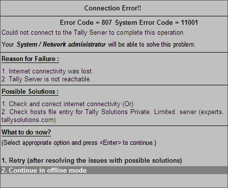

Tally.ERP 9 displays a Communication Error, System Error Code  along with the Reasons for Failure, Possible Solutions and What to do now? (Actions).
  1. Select Continue in Offline mode.

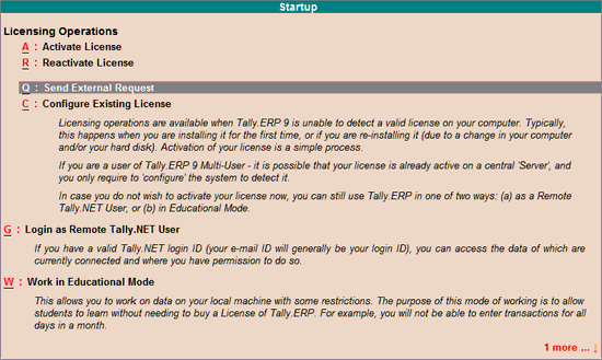

In case Tally.ERP 9 is running in Licensed mode Go to Gateway of Tally > F12: Configure > Licensing > Send External Request
  1. Start Tally.ERP 9 on this computer.
The Startup screen appears as shown below:
  1. Select Send External Request and press Enter.

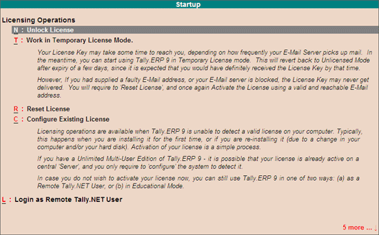

  • In the Startup screen, select Unlock License
The Unlock License screen appears.

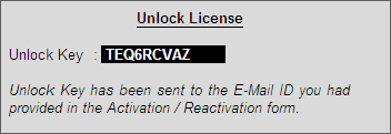

  • Type the Unlock Key retrieved in unlock field or copy the unlock key from the email received and press Ctrl+Alt+V to paste the unlock key.
On successfully unlocking the license file, Tally.ERP 9 displays the following message

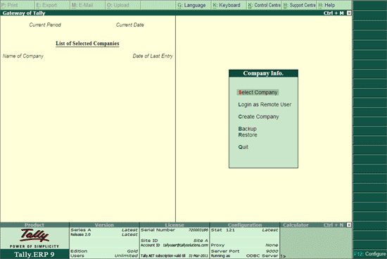

On starting Tally.ERP 9, the License Serial Number and Account ID are displayed under the Version and License  tab of the information panel respectively.
Note: In Tally.ERP 9, the License Activation request can be made from the server or the client machine based on the requirement.
