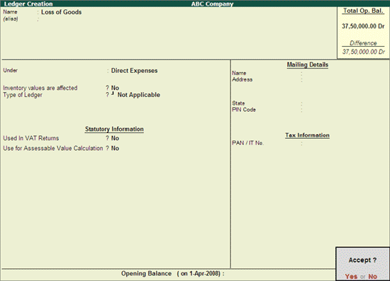

Step 3: Create Direct Expenses Ledger (to account loss of Excise Stock)
To account the loss of Stock create a ledger under Direct Expenses as shown below
