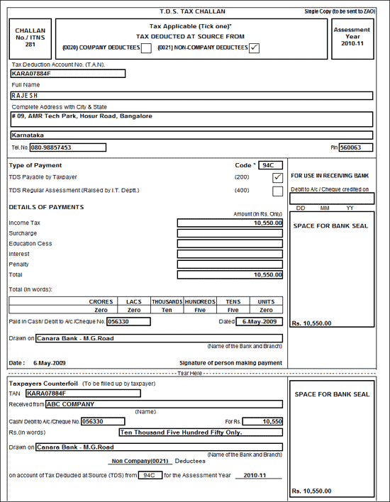

Printing TDS Challan
To Print the TDS Challan press Page Up to view the above Payment Voucher.
From The Payment Voucher screen press Alt+P or click on Print button to view  Voucher Printing screen.
Ensure the Alt+I: Print Preview option is selected to view the print preview of TDS Challan
The Print Preview of TDS Challan ITNS 281 appears as shown
Note: If the concern is a proprietorship firm, then the name of the person responsible mentioned in the Company TDS Deductor Details screen will be captured in the Full Name field of the TDS Tax Challan. If the concern is not a proprietorship firm, then the Company Name mentioned in the Company Creation/Alteration screen will be captured here.
