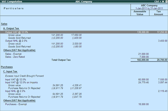

To view the VAT Computation Report,
Go to Gateway of Tally > Display > Statutory Reports > VAT > VAT Computation
The VAT Computation reports provide the Assessable Value and the Tax Amount of the sales and purchase transactions entered using different VAT/ Tax classifications.
The VAT Computation report displays as shown:
The above screen displays the total of tax payable on sales and input tax available on purchases made during the specified period. The essence of VAT is the offsetting of Input tax against Output tax. The VAT computation report shown above precisely indicates the value of Tax Payable after offsetting the input tax against the output tax.
