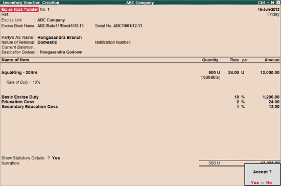

Step 3: Record a Excise Stock Transfer
To record the Excise Stock Transfer voucher,
  1. Go to Gateway of Tally > Inventory Vouchers > Ctrl+J: Material Out
  2. Select the Excise Stock Transfer Voucher Type from the list as shown:
  1. Press F2: Period, and change the date to 15-6-2012.
  2. In Excise Unit, ABC Company will be selected by default.
  3. Excise Book Name and Serial No. will be automatically filled, based on the Book defined on F11: Features.
  4. Select Branch Ledger in Party A/c field. Select Hongasandra Branch from the List of Ledgers.
  5. Party Details sub screen will appear as shown:
  1. Select Nature of Removal as Domestic.
  2. Select branch godown created in Destination Godown field. Select Hongasandra Godown from the List of Godowns.
  3. Select Item that is to be transferred. Select AquaKing - 20ltrs form List of Stock Items.
  4. Fill in Item Allocation sub screen as shown:
  1. Select Duty Ledgers.
Complete Excise Stock Transfer Voucher is recorded as shown:
  1. Press Enter to save the voucher.
