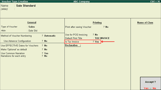

A Sales Voucher Type has to be created/altered  to issue a Standard VAT Invoice
Go to Gateway of Tally > Accounts Info > Voucher Types > Alter/Create
  1. Enter the Name of the Voucher Type
  2. Select the Type of Voucher as Sales from the List of Voucher Type
  3. Abbreviate the Voucher Type as per your requirement in the Abbr. field
  4. Select Automatic for the method of Voucher numbering
  5. Enable the option Use Advance Configuration to specify the numbering method, if required
  6. Set the remaining fields according to your requirements.
  7. Set Is Tax Invoice? to Yes to issue a Standard Invoice
Note: If Is Tax Invoice is set to No, then the Invoice is printed in Simple Invoice format.
  1. Accept the screen to save.
