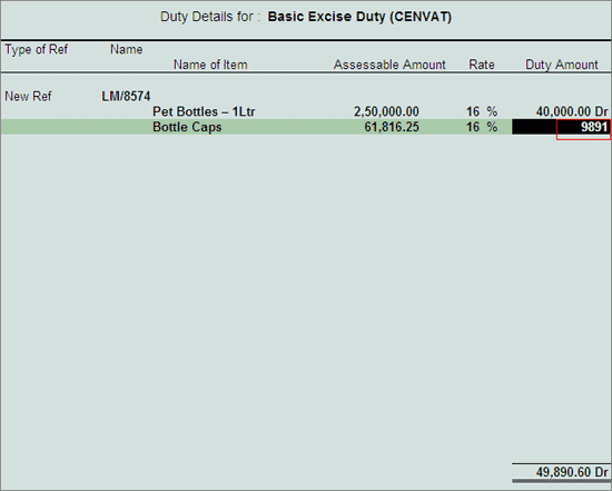

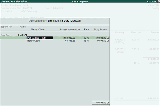

  14. To avail the cenvat credit, select CENVAT type of ledgers - Basic Excise Duty (CENVAT) ledger and press enter to view Excise Duty allocation screen
  • In Excise Duty Allocation screen for stock Item - Bottle Caps,  Duty Amount is displayed as 9890.60 which is Rounded off as 9891 to make the total Basic Excise Duty as 49,891
Note: As per the invoice received from Lanco Manufacturer the Basic Excise Duty is rounded off and is specified as 49, 891. Hence while accounting the credit, duty value is altered to arrive at the actual duty as per the invoice.

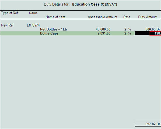

  1. Select Education Cess (CENVAT) ledger and press enter to view Excise Duty Allocation screen
  2. In Excise Duty Allocation screen for stock Item - Bottle Caps,  Duty Amount is displayed as 197.82 which is Rounded off as 198 to make the total Education Cess  as 998

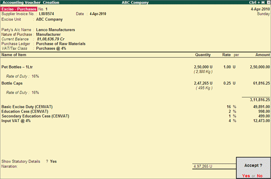

The completed Excise Purchase voucher is displayed as shown
  1. Press Enter to save.
Note: Tally.ERP 9 will store the altered Duty Value even when the voucher is viewed in alteration mode.
