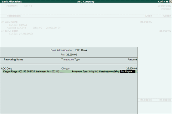

  • Bank Allocation screen appears.
  • Instrument No.: Type the cheque number in the field provided.
  • Instrument Date: The voucher date is displayed by default. Enter the required date, if any.
  • Cross Instrument Using: This is filled by the most common word used - A/c Payee, which is displayed by default. It can be changed as per requirement.
The filled Bank Allocation screen appears as shown:

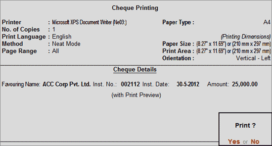

  • The Cheque Printing screen appears displaying the cheque details as shown:
  • Accept to print the cheque.
Printer Selection
Press S: Select Printer button to select the printer and the paper size. Select the paper size as A4.

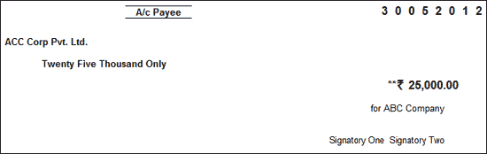

The Cheque Print preview appears as shown:
