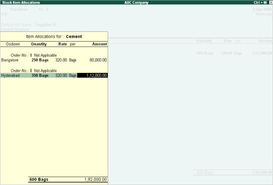

On selecting the Item, an Item Allocations sub screen for the selected Item is displayed as shown.
  1. Select the Godown under the Godown field and specify the quantity to be allocated under the Quantity field.
  2. Enter the Quantity and Rate, and the amount is automatically displayed in the Amount field.
  3. Select another Godown and follow the similar procedure for Item allocation.
