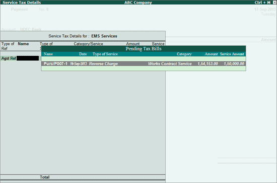

Record the Party Payment Voucher
In reverse charge transactions, Service Tax liability on the  service receiver arises only on making the payment to the service provider.
Go to Gateway of Tally > Accounting Vouchers > F5: Payment
  1. Select the bank ledger in the Account field.
  2. Under Particulars, select the party ledger. In Service Tax Details screen, select the Type of Ref field select Agst Ref and choose the relevant Pending Tax Bill.
  1. Based on the tax bill selected Type of Ref, Category, Amount (Incl. of Tax) and Service Amount will be defaulted.
  1. Press Enter to save and accept.
