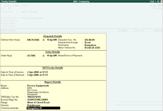

  4. Select the Party’s A/c Name from the List of ledgers e.g. Decora Equipments
  5. The Buyer’s Details sub-form appears enter Despatch and Order details in corresponding fields and accept the screen to save.
Note: The Buyer's Details will appear automatically if specified during the ledger creation.

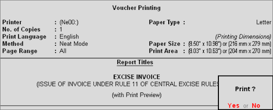

Printing Excise Sales Invoice
The Voucher Printing screen appears as shown since, Print after saving option is enabled in Excise - Sales Voucher Type, if not enabled press Alt+P from voucher alteration screen.
