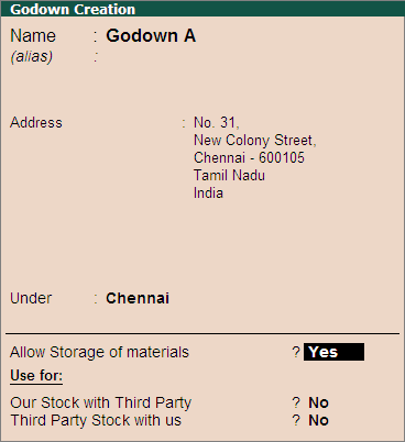

The Location/Godown Creation in Advance Mode screen is displayed as shown.
A brief description of each additional field in Godown Creation screen is given below.
Address
This field is a Multi-Line Field. You can enter the Address for Godown.
Allow Storage of Materials
This option is used for deciding whether storage of material is allowed in this Godown or not.
The Godown for which the Allow Storage of Materials is selected as No, will not appear in the Godowns list, during Voucher entry.
Example:

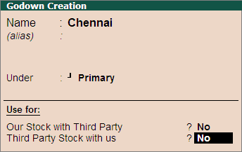

Godown A is under Chennai Location. Here, Chennai is a Location and Godown A is a place where material is stored.
For Chennai, Allow Storage of Materials is set to No, since this will not store the material. During Entry, Chennai will not get listed in the List of Godown.
For Godown A, Allow Storage of Material is set to Yes, since this will store the material. During Entry, Godown A will get listed in the List of Godown.

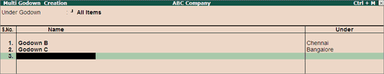

Go to Gateway of Tally > Inventory Info. > Locations/Godowns > Create (under Multiple Godowns)
The Multi Godown Creation screen is displayed as shown.
Under Godown
Select the parent group under which you want the new Godowns to be created. If you select any specific Godown other than All Items, then all the new Godowns will be created under that Godown. Selecting All Items gives you the flexibility of specifying the parent of each new Godown created.
Name
Specify the name of the Godown.
Under
If you select All Items in the field Under Godown, you must specify a parent Godown here. If you select a specific Godown in the field Under Godown, that Godown will be displayed automatically in this column.
