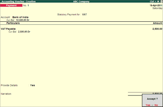

For the above purchase and sales entries, record a payment entry for full payment of VAT dues using the Auto-fill option. In the single entry mode of Payment voucher, select the bank ledger in Accounts field and press S: Stat Payment button (Alt+S). Set the options as shown in Statutory Details screen.
The Payment entry displays as shown:
Set Provide Details field to Yes and enter the VAT Payment Details.

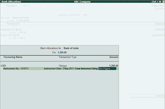

After accepting VAT Payment Details, the Bank Allocations screen appears. The Bank Allocations for field displays the bank ledger selected in Accounts field of payment voucher. Under Payment Favouring for, enter the name in whose favour the payment is being made. Select the required Transactions Type. The payable amount is captured in Amount column. The cheque number entered in VAT Payment Details screen needs to be entered in Instrument No. field, the Instrument Date is captured from Voucher Date. If Cheque is selected as the Transaction Type the Cross Instrument Using field will be displayed as A/c Payee. On selecting any other Transaction Type, the Cross Instrument using field will not be displayed.
Accept the payment entry.
