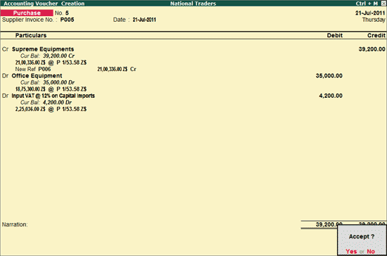

Import of Capital Goods
In the purchase voucher,
  1. Enter the Supplier Invoice number and date.
  2. Credit the Supplier Ledger from the List of Ledger Accounts.
  3. Enter the purchase value in Credit field with the foreign currency symbol - Z$.
  4. The Forex Rate of Exchange screen will be displayed for entering the conversion factor. Enter the conversion factor and accept the Forex Rate of Exchange screen.
  1. In the Bill-wise Details for sub-screen, select the Type of Ref from the list of Method of Adj and enter the Name, Due Date, Credit Days and the Amount.
  2. Debit Office Equipment grouped under Fixed Assets with the VAT/Tax class - Purchases - Capital Imports @ 12%.
  3. Enter the value excluding the VAT amount with the foreign currency symbol - Z$.
  1. Debit Input VAT @ 12% on Capital Imports ledger grouped under Duties & Taxes with the Type of Duty/Tax as VAT, VAT Sub Type as Input VAT and VAT/Tax class - Input VAT @ 12% on Capital Imports.
  2. The Debit Amount is automatically entered.
  3. The Forex Rate of Exchange screen will be displayed with the currency conversion factor.
  4. Enter the details in the field Narration, if required.
Note: The gross assessable value of purchases recorded using the VAT/Tax class - Purchases - Capital Imports @ 12% is captured in Standard Rate column of box 13. The input tax entered using the VAT ledger predefined with VAT/Tax class - Input VAT @ 12% on Capital Imports gets displayed in Total Input Tax Claim column.
