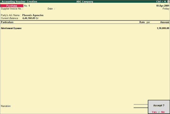

Go to Gateway of Tally > Accounting Vouchers > F9: Purchase
  1. Press Alt + I for Account Invoice mode
  2. Press F2 and change the date to 10-04-2009
  3. In Party’s A/c Name field select Phoenix Agencies from the List of Ledger Accounts
  4. Under Particulars select Advertisement Expenses
  5. Enter Rs. 1,50,000 in the Amount field

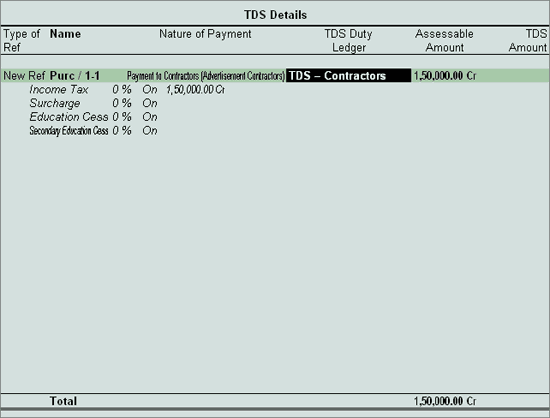

  7. Press Enter twice to view TDS details screen.
  8. In TDS Details screen.
  9. Select New Ref in the Type of Ref field
  10. Name field displays the Reference Number, which is a combination of abbreviation of Purchase and Voucher Number. Example: Purc / 1-1 which can be changed by the user. TDS deductions are tracked with these Reference Numbers.
  11. In Nature of Payment field select Payment to Contractors (Advertisement Contractors) from the List of Nature of Pymt(s)
  12. In TDS Duty ledger field select TDS – Contractor
  13. Assessable Amount will be defaulted Rs. 1,50,000
Note: TDS Details screen is provided for an expenditure for which Tax is not deducted at the time of accounting of expense, to provide the TDS details, which will be used as reference at the time of cumulative deduction of Tax.

  1. Enter Narration, if Required
  1. Press Enter to accept and save.

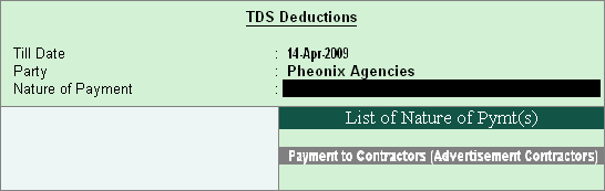

  2. Press Alt +S or click on S: TDS Deduction button on the buttons bar to view TDS Deductions screen.
  3. In TDS Deductions screen:
  4. Till Date: In this field, enter the till date of the period for which the TDS to be deducted and auto–filled.
  5. Party: Select Pheonix Agencies from the List of Ledger(s) In this field Tally.ERP 9 displays the List of Party ledgers against whom the TDS deduction is due.
  • Nature of Payment: Select Payment to Contractors (Advertisement Contractors). Based on the Party selected in the Party field, Tally.ERP 9 displays all the party related nature of payments under which TDS deduction is pending.

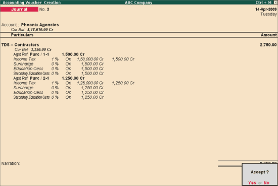

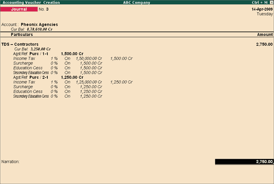

  1. Accept the TDS Deductions to auto-fill the TDS amount with the respective bill details.
Note: The Total TDS of Rs.2,750, includes TDS of Rs.1,500 against Purc /1-1 and Rs. 1,250 against Purc / 2-1.

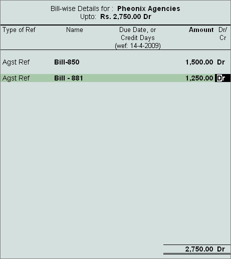

  1. In the Bill-wise Details screen details will be defaulted as shown.
  1. Enter Narration, if required.
