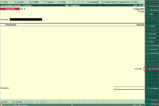

  1. Enter the Date as 3-8-2012
  2. Press Alt + S or click on S: Stat Payment to view Statutory Payment screen
