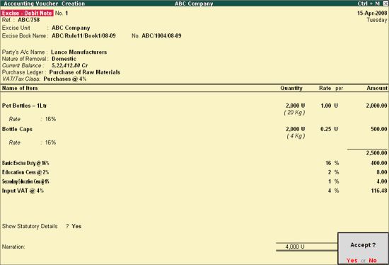

Go to Gateway of Tally > Accounting Vouchers > Ctrl + F9: Debit Note
  1. In Voucher Type sub form select Excise – Debit Note as the voucher type.
  2. Ensure that the Debit Note voucher is in Item Invoice Mode.
  3. Enter the Date as 15-4-2008.
  4. Enter the Ref details as ABC/758.
  5. In Excise Unit field Tally.ERP 9 displays ABC Company, as selected during voucher type creation.
  6. Excise Book Name field displays the name of the excise invoice book (ABC/Rule11/Book1/08-09) created for the Excise Unit.
  7. Serial No. field displays the Rule 11 invoice Number e.g. ABC/1004/08-09.
  8. In Party A/c Name field select Lanco Manufacturers from the List of Ledger Accounts.
  9. In Nature of Removal field select the option Domestic from the list of Types of Removals.
  10. In Purchase Ledger field select the ledger Purchase of Raw Materials from the List of Ledger Accounts.
  11. VAT/Tax Class field automatically gets updated with the VAT/Tax class as selected in the sales ledger, which can be changed.
  12. In Name of Item field select the Stock Item i.e. Pet Bottles – 1Ltr.
  13. In Quantity field enter the quantity as 2,000.
  14. In Rate field enter the rate as Rs. 1.
  15. In Name of Item field select the Stock Item i.e. Bottle Caps.
  16. Enter the  Quantity as 2,000 and Rate as Rs.0.25.
  17.  Select Duty Ledger i.e. Basic Excise Duty @ 16%. Amount will be calculated and displayed automatically.
  18. Select Education Cess @ 2% and Secondary Education Cess @ 1% ledgers. Amount will be calculated and displayed automatically.
  19. Select Input VAT @ 4% as the Vat duty ledger. Amount will be displayed automatically.

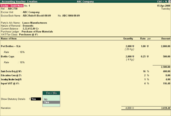

  20. Set the option Show Statutory Details to Yes to view the Statutory Details screen.

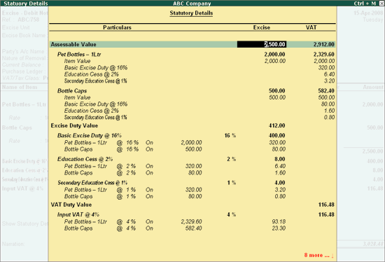

  1. In Statutory Details screen press Alt + F1: Detailed to view details of duty calculation. The Statutory Details screen is displayed as shown.

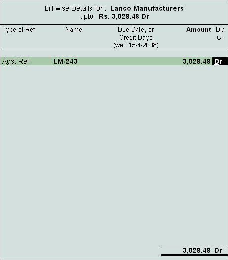

  1. In Bill-wise Details screen, select Type of Ref as Agst Ref and select LM/243 dated 3-4-2008.

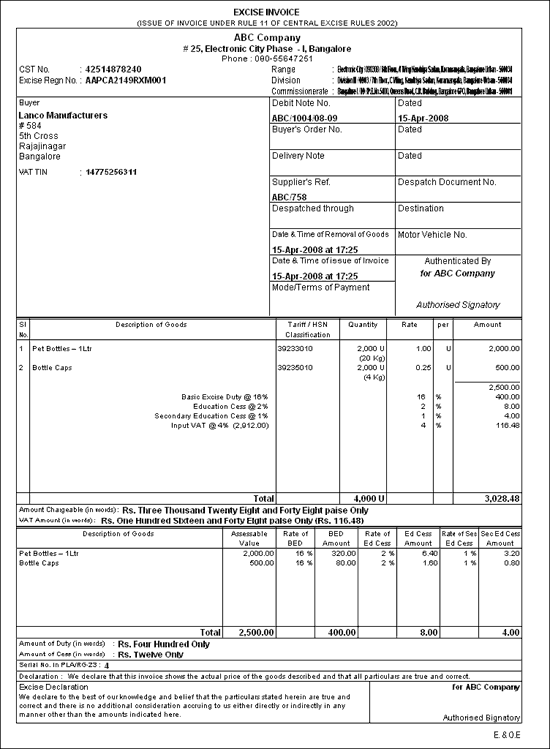

Print Rule 11 Invoice
Print Preview of Rule 11 Invoice for Purchase returns appears as shown
