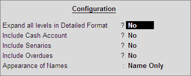

To configure Cash Flow Projection, press F12: Configure.
Expand all levels in Detailed Format
The report can be viewed in detailed mode with sub-groups expanded.

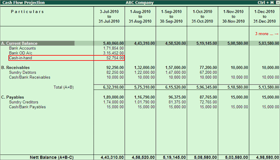

Include Cash Account
By default, the Cash Flow Projection report excludes the Cash Account.
  • Set the option to Yes to display the Cash Flow Projection including Cash Accounts, as shown:

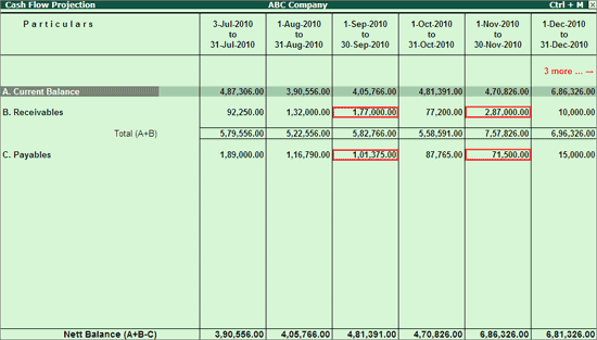

Include Scenarios
The Cash Flow Projection report can be viewed with scenarios in order to project the cash flow based on the requirement. By default, the option Include Scenarios is set to No. The report with scenarios excluded appears as shown:
Set the option to Yes to display the Cash Flow Projection report with scenarios as shown:
Note: The scenario entries may be passed using the Optional, Reversing Journal or Memorandum vouchers. Enable the option Use Reversing Journals & Optional Vouchers under Budgets & Scenario Management in F11: Accounting Features to activate the same.

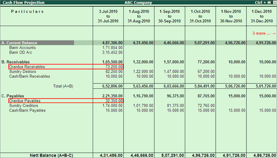

Include Overdues
The Cash Flow Projection report in Tally.ERP 9 displays the projections by default on monthly basis based on the last date of entry made till the end of the selected period. The user may change the period based on the requirement. In addition to this, the report can also be viewed including the receivables and payables which are due prior to the selected period.
The option Include Overdues is by default set to No.
Set the option to Yes to display the Cash Flow Projection report with overdues as shown:
