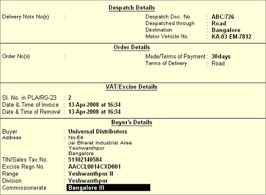

  9. In Party Details sub form
  10. Despatch/Order Details: Under these two sections enter the Despatch and Order Details
  11. Sl.No. in PLA /RG-23: In this field enter the Sl.No. in PLA /RG-23 register as 2
  12. Date & Time of Invoice: In this field enter the time Date of Invoice. Tally.ERP 9 by default displays the system time and date in this field which can be changed
  13. Date & Time of Removal: In this field enter the Time & Date of Removal of Goods. Tally.ERP 9 by default displays the system time and date in this field which can be changed
Note: As per Central Excise Invoice System, in all the sales invoice time and date of removal has to be printed.
  • Buyer Details: In this section Tally.ERP 9 by default displays the details provided during buyer ledger creation, which can be changed.

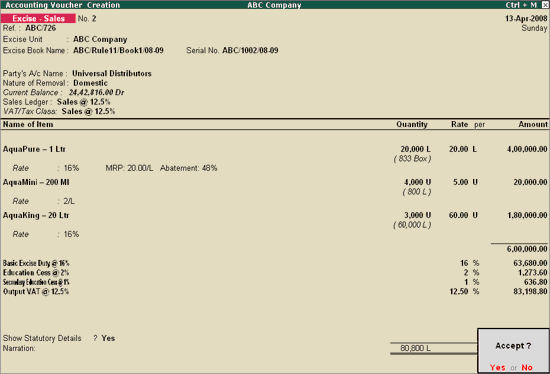

  4. In Name of Item field select the Stock Item i.e. AquaPure - 1Ltr.
  5. In Quantity field enter the quantity as 20000.
  6. In Rate field enter the rate as Rs. 20.
  7. Amount will be displayed automatically.
  8. In Name of Item field select the Stock Item i.e. AquaMini – 200 ml as the second Item.
  9. Enter 4000 as Quantity and Rs. 5 as Rate.
  10. In Name of Item field select the Stock Item i.e. AquaKing – 20 Ltr as the third Item.
  11. Enter 3000 as Quantity and Rs. 60 as Rate.
  12. Select Duty Ledger i.e. Basic Excise Duty @ 16%. Amount will be calculated and displayed automatically.
  13. Select Education Cess @ 2% and Secondary Education Cess @ 1% ledgers. Amount will be calculated and displayed automatically.
  14. Select Output VAT @ 12.5%. Amount will be calculated and displayed automatically.

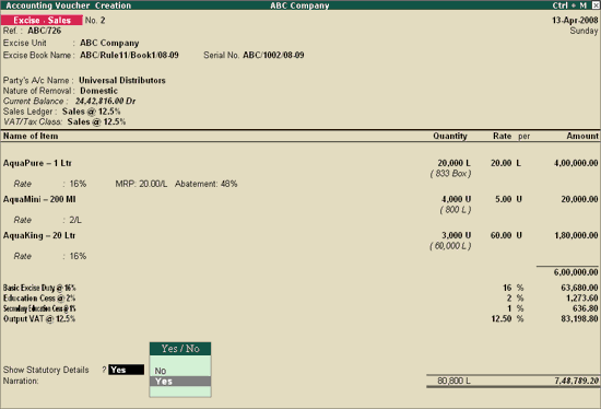

  15. Set the option Show Statutory Details to Yes to view Statutory Details screen.

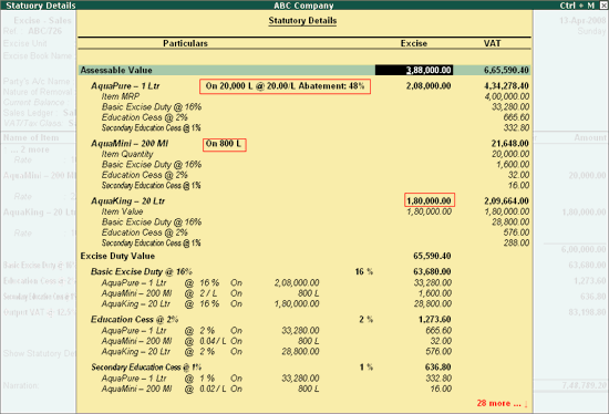

  1. In Statutory Details screen press Alt + F1: Detailed to view details of duty calculation. The Statutory Details screen is displayed as shown.
Note: In statutory details user can view Item/ ledger wise assessable value and Duty/Tax calculations.
For the stock item AquaPure - 1Lt, valuation Type selected is MRP Based, MRP is Rs.20/L and the Abatement allowed is 48%.
  • Assessable Value: Sales Quantity * Rate = Total Amount – Abatement (Total Amount*48/100)
  • Rs. 2,08,000: 20,000*20 = 4,00,000 – 1,92,000 (4,00,000*48/100)
On the Assessable Value (2,08,000) BED is calculated @ 16%. Education Cess @ 2% and SHE Cess @ 1% is calculated on BED
For the Stock Item AquaMini – 200ml, Valuation Type selected is Ad Quantum (duty is calculated on quantity)
  • BED is defined @ 2/L (on the Reporting UOM - Liter), Education Cess @ 0.04/L (2% of Rs. 2) and Secondary Education Cess @ 0.02/L (1% of Rs.2)
  • BED for AquaMini – 200ml is calculated on (4000*0.200ml) 800 liters (800*2 = 1600)
  • Education Cess for AquaMini – 200ml is calculated on 800 liters (800*0.04 = 32)
  • Secondary Education Cess is calculated for AquaMini – 200ml is calculated on 800 liters (800*0.02 = 16)
For the Stock Item AquaKing – 20 Ltr, Valuation Type selected is Ad Valorem
  • BED @ 16% is calculated on the Transaction Amount/Assessable Value of Rs. 1,80,000 (180000*16/100 = 28,800)
  • Education Cess @ 2% and Secondary Education Cess @ 1% is calculated on BED

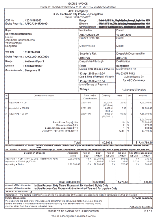

Printed Excise Invoice
