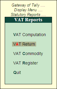

Go to Gateway of Tally > Display > Statutory Reports > VAT Reports > VAT Return
