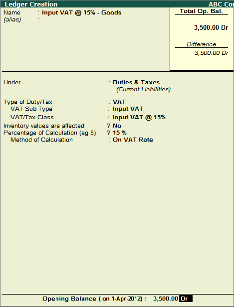

To create an Input VAT Ledger:
Go to Gateway of Tally > Accounts Info. > Ledgers > Create
  1. Enter the Name of the VAT ledger, for e.g., Input VAT @ 15% – Goods
  2. Select Duties & Taxes as the group name in the Under field
  3. Select VAT from the Types of Duty/TAX list in the field Type of Duty/Tax
  1. Select the VAT Sub Type as Input VAT
  2. Select the VAT/TAX Class as Input VAT @ 15%
  1. The Percentage of Calculation and Method of Calculation will be displayed based on the VAT/Tax Class selected.
  2. Enter the Opening Balance, if any
  1. Accept the input VAT ledger creation.

Note: The opening balance entered in the input VAT ledger creation screen will be captured in Box 18 of MUSAK-19 as the Closing balance of previous period.
The input VAT is chargeable at a fixed rate of 15% on both purchase of goods and service.
