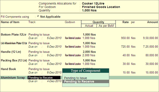

  • Name of Item: Select the Raw materials required to manufacture the finished Goods. E.g. Bottom Plate-12Ltr
  • Track: In this field select Pending to Issue from the Type of Component list as the Raw materials are pending for issue to the Job Worker.
Note: Based on the Job Work Order Tally.ERP will highlight the appropriate Type of Component.
* For Job Work Out Order - Pending to Issue will be highlighted

  • In the process of Manufacture of Cooker 12Litre, Aluminium Scrap is produced. Under Name of Item select Aluminium Scrap and in Track field select Pending to Receive as the scrap has to be received form the Job Worker along with the Finished goods.

The completed Components Allocation screen is displayed as shown
  • Press Enter to accept the Component Allocation screen and to view Stock Item Allocation screen
