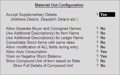

Press F12 configuration to enable/disable other options as shown:
